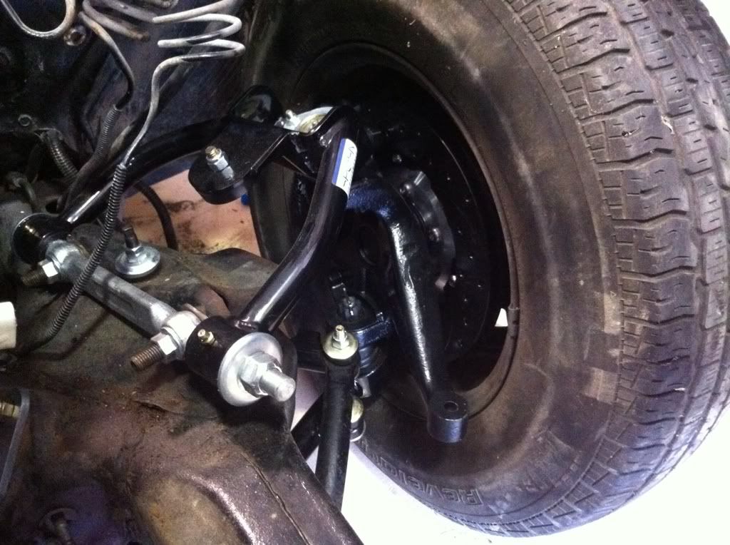

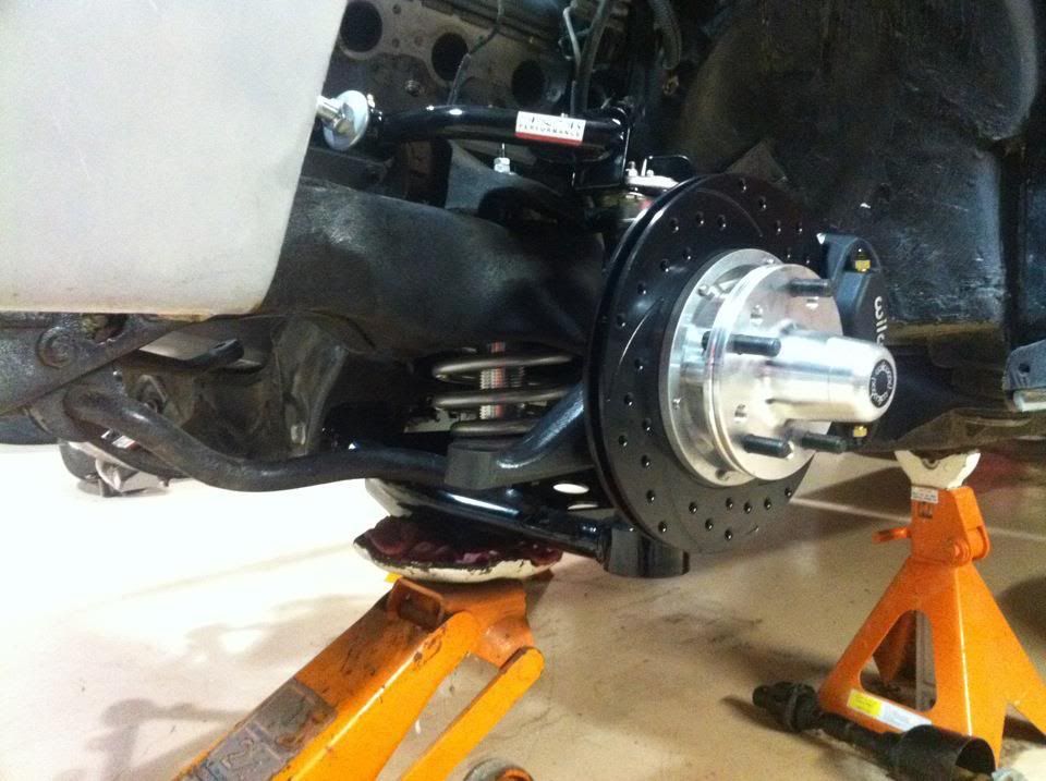

Hood
Control Arms (upper/lower tubular)
Aluminum Coilovers
Forged Aluminum Brakes
Removed stock steel/brass brake line blocks, replacing with lightweight aluminum T's
Lightweight Forged Master Cylinder (manual brake conversion)
Kirkey 20" Seats - With covers.
No A/C (came with heater only)
ATI Aluminum Balancer - without A/C drive
Wheel tub delete - May put carbon fiber panels in with Dzus fasteners
Modified drop spindles
Guesstimating total weight savings thus far to be 150-200lbs.

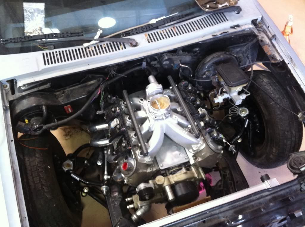

Hood clears really well. I'd say there's a good 1.5" above the intake manifold.
